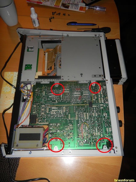

sorry to hear that the things are worsening up. One point took my attention. You wrote that the Rec function is out of order and doesn't work.
Is anything else affected e.g. Slider illumination, Slider motor or Dolby function? The point is that the velocity impacting your C3 might have suffered during the transportation is able to cause internal damages.
To make sure that the main amplifier PCB is not affected it might be a managable task to dismount the bottom plate of your tape if you turn the C3 upside down. There are a couple of Screws which need to be removed to enable you taking a look inside. You will have direct view to the Main PCB. You only need to check the four fixation points of the main amplifier PCB to the C3 metal frame.
Please have a look to the picuture below:
The red encircled areas are under interest. If you find any sign of a crack in the circuit board you are in trouble. If so call me.
It is of coarse up to you to open the bottum plate but I think the risk to further worsen the situation will be minimal.
Please disconnect the AC plug before starting any action to unplug the bottom plate. Don't touch the PCB if possible. It is only a chance to isolate the problem. Opening the bottom plate might be usefull if some of the discribed functions from the C3 are off.

#8 Beitrag von thebeathunters » 07.04.2011, 00:46
hi jens, ji gereon
thanks for your support and your help, it's really kind of you and means a lot.
about your remarks:
actually, the light on the tray is still on and the speed -play/ff/rew-seems unaffected.
the red dot lights up when recording is on and the monitor shows some activity/volume input but nothing gets recorded on tape...
the procedure you're showing on picture seems in my league so i'll give it a try and post a picture of the inside.
