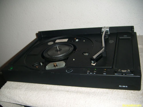

Hello and welcome here!
I guess the P501 is similar to the PS550S.
Braun-Wiki
So you can use the belt from the PS550S. It is still available. Take a look in ebay.

#3 Beitrag von Mathias bastiaensen » 21.05.2013, 17:02
Thank you, i found a picture of an open PS 550 S and it looks the same indeed!
I'll look around ebay to find a replacement belt

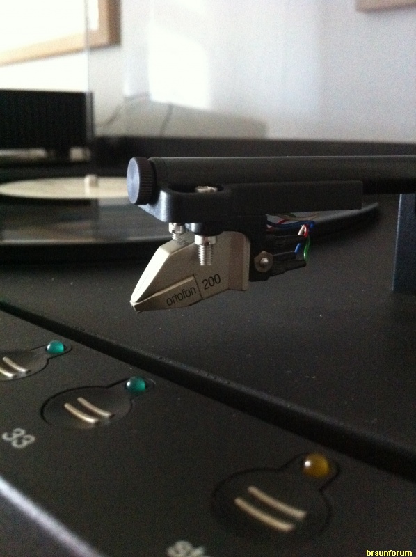

#10 Beitrag von Mathias bastiaensen » 23.05.2013, 19:53
This is my Ortofon 200...
Beiträge: 851
#11 Beitrag von Wilhelm » 23.05.2013, 21:30
Hi Mathias,
you can find hundreds of articles about mc and mm cartridges on the internet, but you can't see the difference just by looking at it.
The easiest way to differentiate between the two would be using an Ohm-Meter. MC cartridges have usually a resistance of a few Ohms (measured across the ground and left or right channel) MM systems around 1K Ohm. If you find that yours is a mm system, the fault is probably in the phono stage.
At first make sure that the voltage across C1109 is about 30V (coming from the power supply). If the voltage is correct, I would recommend to exchange the electrolytic capacitors C1102, C1202, C1108 and C1208. Please consider that long distance repairs are often like looking into a crystal ball.
Of course, the easiest test with your set-up would be connecting another record player.
Regards
Please note that it is dangerous working on components under power.
Mathias bastiaensen
Beiträge: 11
Registriert: 18.05.2013, 12:13
#12 Beitrag von Mathias bastiaensen » 24.05.2013, 20:29
Oke, i am very stupid, on the other side of the needle is tmc 200!
So i looked at my atelier set and the i have a phono mc or mm input.
I wanted to switch the needles, but i guess they are not compatible!
Thanks for all the help, i now know what the problem is!
