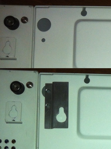

Hello Rocco,
You definitely need the parts pictured above.
With the the sketch above you can go to a local metal worker. They will able to create a pair for you.
I did the same some month ago.
The bottom of the TG60 is prepared for the fittings. You need to remove one of the rubber legs. The 2nd screw holds the bottom to the case.
I can make picture this evening.
Hagen

On the left you can see the TS45. The right chassis of the TG60.
My TG-60 has no screws because because it is freshly painted - thanks a lot to Mr. Wölker in Darmstadt.
Hagen
