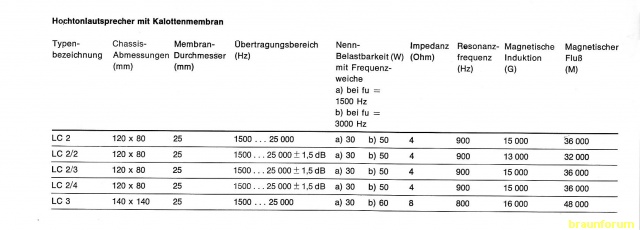

From technical point of view I would estimate that the differences between LC2 and LC2/4 are minor. Please have a look to the Screenshot I made from an old Braun broschure from 1973 where you can compare both driver units by its specs.
Nevertheless I would recommend to try keeping consistancy between both loudspeeker by taking the original tweeter configuration on both sides. You might face a hardly noticable inbalance which could influence the quality perception subtile.

according to my records the newer LC 2/4 replaces the older LC 2. There should be no difference in acoustic quality between both.
Regards,
