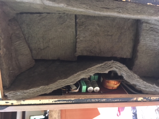

With the cabinet open you encounter several pieces of insulation that can be simply removed to discover the crossover.

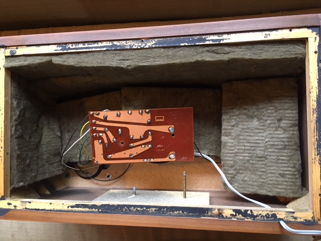

The crossover is secured by two 8mm nuts. Remove those and the crossover can be removed from the mounting bolts.

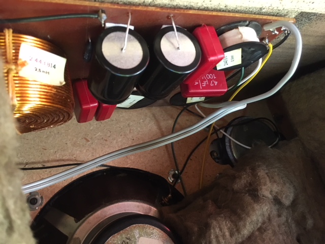

I replaced the capacitors and was surprised that the original capacitors all measured around 60uF. I don't have the right device to measure the ESR but I wonder if these caps could still be good? Replaced with single 47uF Plain Mundorfs - fit well and all measured around 51uF. I didn't see a reason to add another in parallel. I used 3M double sided tape to secure the capacitors. (Edit: In the picture it looks like one of the Mundorfs is pushing the adjacent red capacitor over but it was already leaning that way and there is space between).

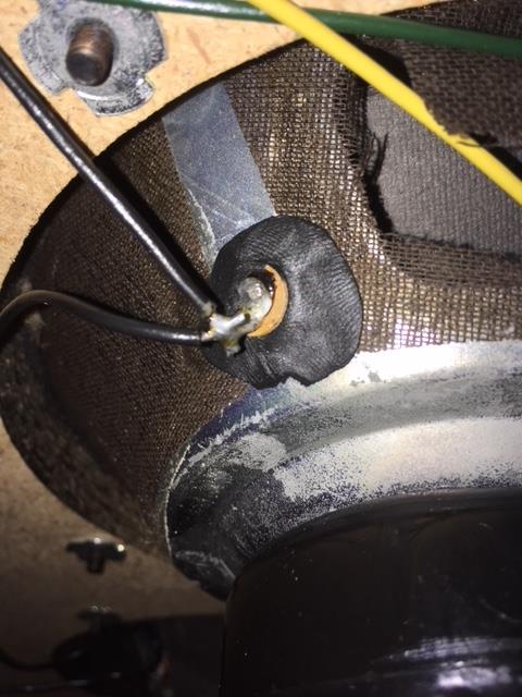

In my picture you can see the outer paper support ring, then a little copper ring, and then (on the inside) what appears to be another paper support ring. I'm wondering if there is another copper ring on the inside near the voice coil that requires cutting open the linen covering to retrieve as was described on the hifimuseum site - or is this the only ring that needs to be dealt with? Any suggestions on how to approach this repair would be very much appreciated.

Our speaker expert Rainer Hebermehl asked me to forward the following repair instructions.
The rivets on the speakers are faulty. For better handling you should remove the woofers and cut out the screen covers which you don’t need anymore. You will find loose wires with the faulty rivets and a black grommets. Desolder the wire and remove any remnants. Glue the paper grommet to the outside of the housing, feed the wire through the grommet, connect (solder) to the speaker wiring and mount (glue) to the woofer basket. Make sure there is no connection from the wires to the basket.

I believe the wire is still glued to the woofer cone as it's still functioning (there is no loose/detached wire) but the adhesive for the rivets and paper grommets has failed.
Here is an example from the hifimuseum site:
As a temporary measure I secured the external grommet and rivet with butyl putty externally. Then I reached inside and used butyl putty to secure the internal grommet and rivet to the inside of the basket. I was careful to keep the wire from contacting the basket.
I'm guessing there originally was a paper grommet on either side of the basket, a metal rivet on the basket side and a metal rivet at the cone. So the metal rivets are not necessary? I think he suggested just removing them altogether.

You are correct, there is one black grommet und one paper grommet on either side of the basket. If the rivets on the basket are still usable please use them again as solder terminals. Do not remove the rivets attached to the cone!
