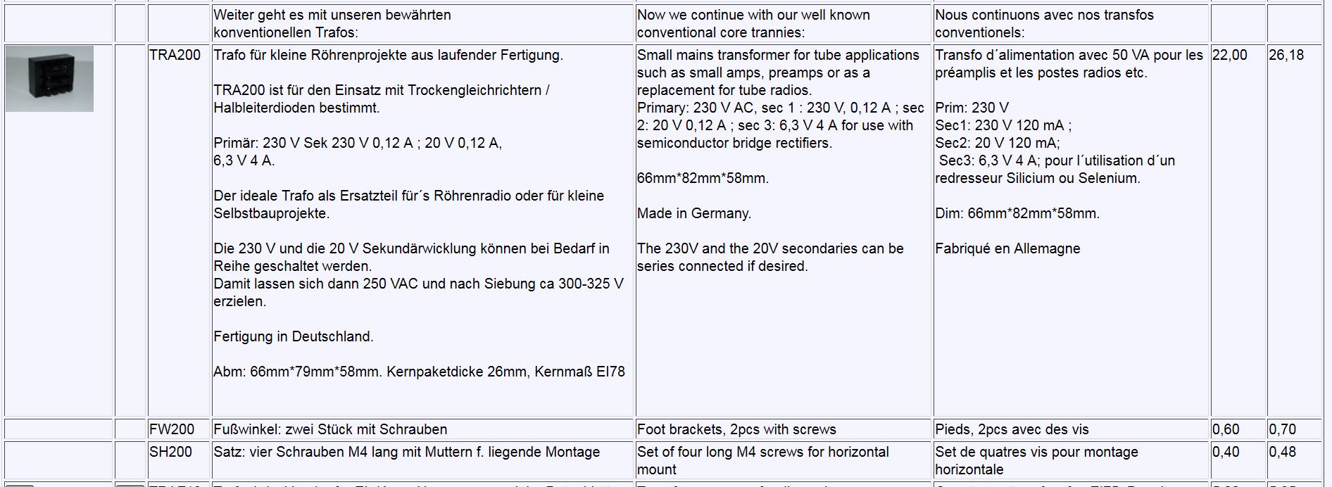

Please have a look to the screenshots (Ask Jan First) and the preselected components:
TRA200: This transformer is on the low side but within specification of Rainer (Nice price & small).
TRA0201: This is a more powerfull transformer on sec.1 (2*230V / 100mA - parallel wiring) which might be the better choice. The sec.2 heater output (6,3V / 3A) is a bit less powerfull compared to the TRA200 but still OK. If you want to be on the safe side, it is a rule of thumb to dimension the transformer output (current) by adding 50% plus as a reserve to withstand the peak amplification and stress on the long run.

If you contact Mr. Wüsten on his homepage (contact Sheet) he will assist you to pick the best fitting components if you ask for.
