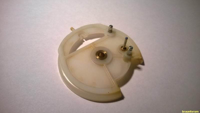

I bought two turntables Braun ps-500 and the mechanism detail start-stop is broken in both tuntables. Could you advice where can I buy this detail?

Ich habe zwei Plattenspieler Braun PS 500 gekauft und in beiden Plattenspielern ist das Detail des Mechanismus der Starts-Füße (gebrochen Sie sehen das Foto).
Sie könnten nicht empfehlen, wo ich dieses Detail kaufen kann?

Hello!
Billet parts are ready. Now it is necessary to make axes and assemble. :)

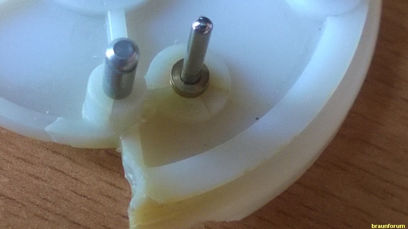

zbyszek hat geschrieben:
The original part looks perfectly fine for me. Why do you say it's broken?
Hi!
The first part has radial wear from the pin, leading to shock loads and numerous cracks. A condition of the second part is even worse. A service man said that the use of these parts will lead soon to large mechanical damage.
Kind regards,
Alexey
Beiträge: 1262
#5 Beitrag von wickerge » 01.05.2014, 11:37
Hello Alexey,
what is the material the replacement parts are made of? I see the danger that the replacement parts are mechanically less stable compared to the original parts.
On the other hand I do not see a danger for the rest of the turntable if you try to repair the original parts. It is a mechanically quite simple on/off switch and easy to understand. If you take away the platter and sub-platter and move the on/off knob, you will understand what the part does.

wickerge hat geschrieben:Hello Alexey,
This is how it looks in my PS 500 - the part is also a little bit damaged, but still working:
Best Regards
Hi Gerhard!
The parts are made on the professional 3D-printer. The material as me said is a special glass bead filled polyamide with a high mechanical properties.

#7 Beitrag von AlexP68 » 11.06.2014, 18:34
