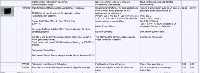

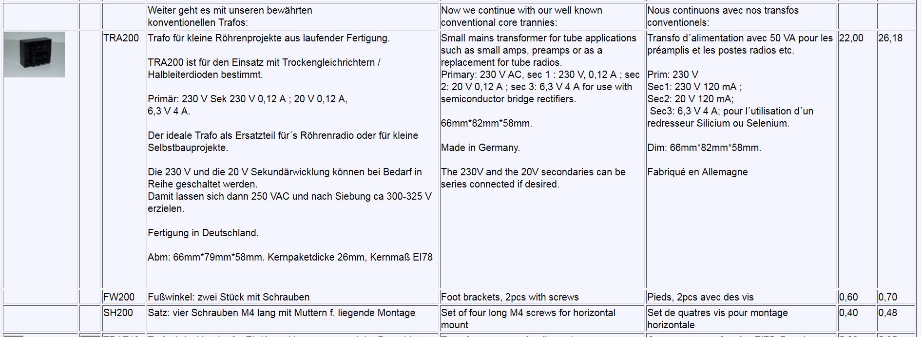

Please have a look to the screenshots (Ask Jan First) and the preselected components:
TRA200: This transformer is on the low side but within specification of Rainer (Nice price & small).

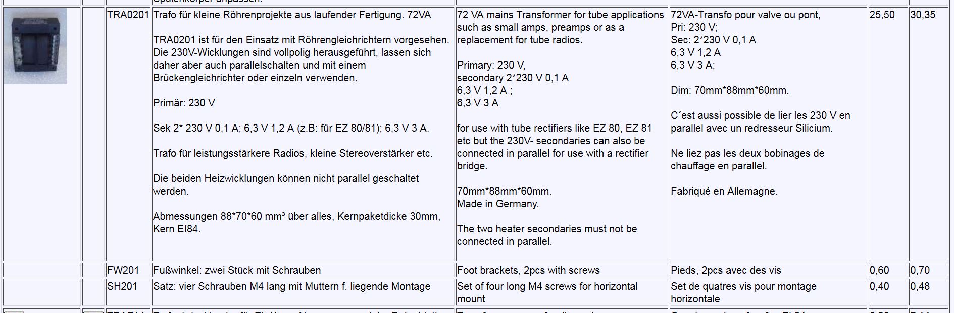

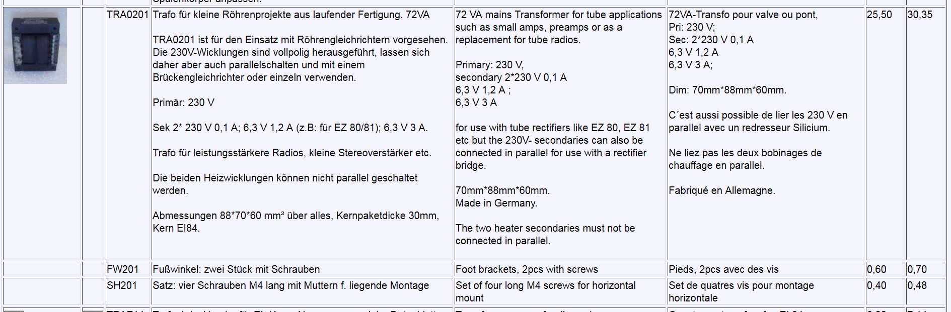

TRA0201: This is a more powerfull transformer on sec.1 (2*230V / 100mA - parallel wiring) which might be the better choice. The sec.2 heater output (6,3V / 3A) is a bit less powerfull compared to the TRA200 but still OK. If you want to be on the safe side, it is a rule of thumb to dimension the transformer output (current) by adding 50% plus as a reserve to withstand the peak amplification and stress on the long run.
Don't forget the foot brackets and screws which are necessary and not at all a cost factor.
If you contact Mr. Wüsten on his homepage (contact Sheet) he will assist you to pick the best fitting components if you ask for.

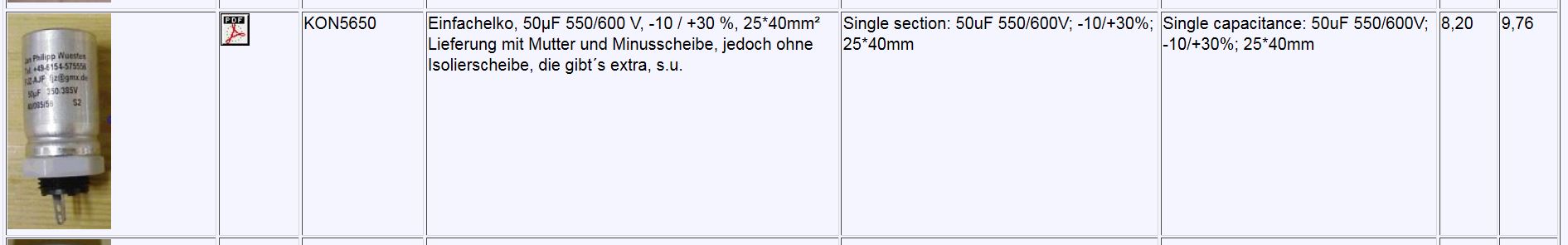

KON5650: I spotted a hint from your repair shop that the reason for the broken transformer might be related to a leaked Capacitor. To avoid the risk of further sudden death for any new transformer you should replace this one, too. The high voltage 50uF Electrolytic Filter-Capacitor within the power supply section (according to the circuitry scheme) might be the defective one they are referring to. Please have a look into your SK55 Power supply to identify the defective capacitor and compare it with my replacement suggestion on the Screen shot below (Screw-in metal dome capacitor).

There are two transformers which obviously meet the specification mentioned by Rainer. These are not originals but low power tube transformers out of current production which probably fit.
