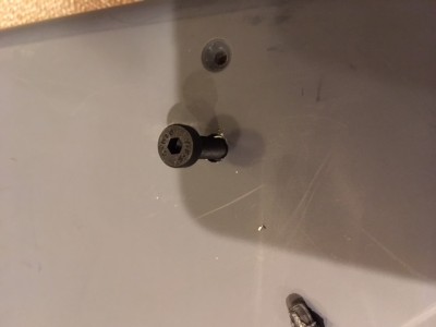

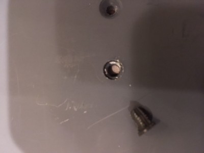

Hello all,

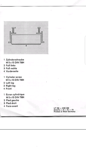

I was wondering if someone knows the correct size mounting screws for the LF700 stands. I thought it was M5 x 15 based on the document below but they don't seem to thread easily into the back of the 710s. I'm not sure if my 710s ever had the stands mounted as the little plugs on the back are still in place.
Thank you once again!
Jon
Edit: Erfolg! Just need to be a little more brave and get them started.
I can confirm that M5 x 15mm is the correct size.
Zuletzt geändert von SX-70 am 15.10.2017, 05:42, insgesamt 1-mal geändert.

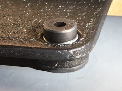

Hardware used for mounting stands:
M5 x 15mm DIN 7984 (I could only find M5 x 16mm long but they work).
M5 metal washer
M5 or 3/16" neoprene washer
