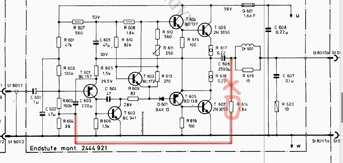

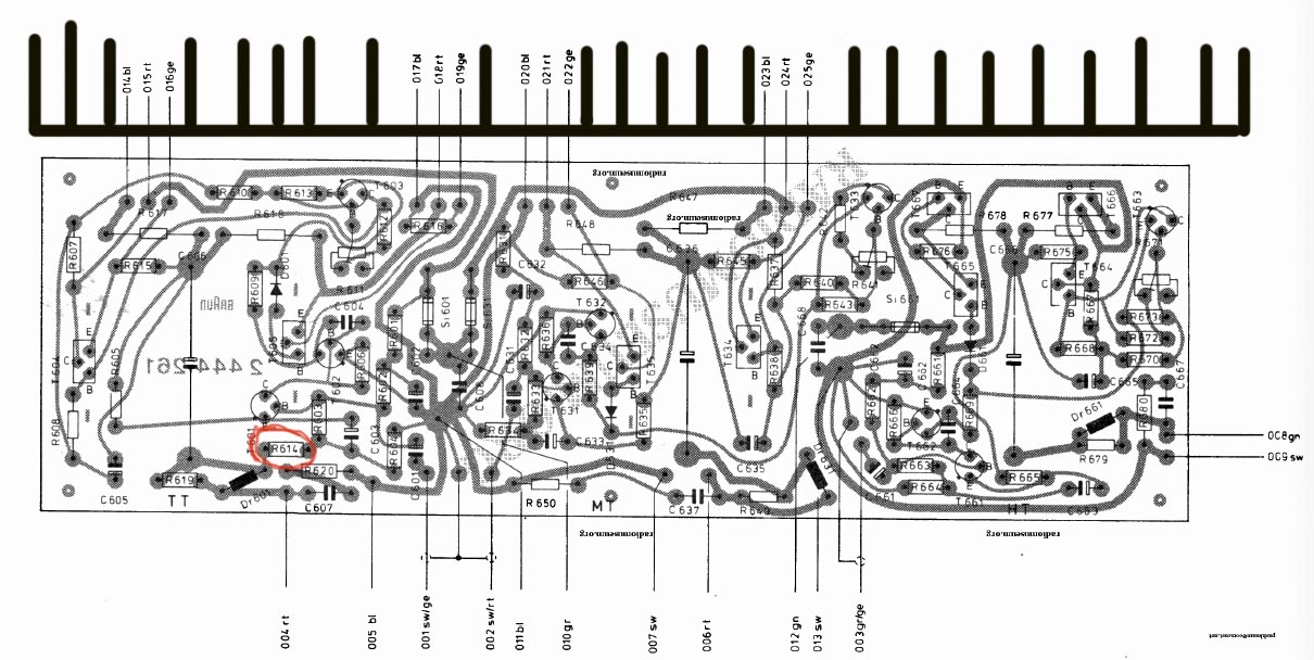

Cut off feedback to amp in LV1020
#5 Beitrag von pashka » 11.11.2018, 08:06
Tip 2
Improving the sound by 40% up,
Тurning off the feedback in the LF . Take off one leg of resistor R614 on LF amplifier. 1.8 Kohm
Feedback resistor is not worth on the other two amplifiers MF and HF.
What does the feedback do? Sends the output back to the input of the amplifier. The sound is compressed, dead sound.
Unsolder one leg resistor R614, you interrupt ( CUT) the feedback.
Possible perhaps Broun did this to relieve the load from the low-frequency amplifier and speaker, so that lovers of very loud music do not overload the amplifier.

Re: Sound improvement on LV1020: Capacitors a.o.
#6 Beitrag von henry2 » 12.11.2018, 14:10
Hi Pashka,
thank you for your tips. At first, I would like to draw attention to a bad mistake in the circuit diagram. Of course, the connection between the emitter of T605 and R615, bridging R618, must not exist. This is doubtless a drawing error, which was overlooked by the 'lector'.
As far as the negative feedback via R614 (1.8 KΩ) is concerned, it does not relieve the power amplifier at higher volume levels, but counteracts the mutual induction when the membranes of the bass speakers overshoot. It basically increases the damping factor of the output stage. I also don't think that this will affect the sound quality noticeably and I would recommend leaving this negative feedback as intended.
Incidentally, exactly the same negative feedback was also implemented in the amplifier CSV 510 and in the receivers Regie 510 (CEV 510), Regie 520 (CEV 520) and Regie 530. These are all devices that, among other things, were also well known through its very good sound.
Best regards
Edit: I changed the expression atenunation factor in damping factor which i think is in this context more correctly.

henry2 hat geschrieben:Hi Pashka,
Heinrich thanks for the interesting advice.
I did not notice this difference in the scheme (connection between the emitter of T605 and R615) .
My idea was to make all three amplifiers the same according to the scheme and remove the feedback as an appendix. Now I will change the circuit (connection between the emitter of T605 and R615) in the amplifier and listen to the difference.

#9 Beitrag von pashka » 12.11.2018, 21:22
When I wrote that I would change the scheme today by connecting between the emitter of T605 and R615, at that moment I thought that it would change and improve the bass, because what I now have sounds like the ultimate dream.
It turned out that I did not carefully read the text of the error only in the schematics on paper, everything is fine on the board itself.
Thanks .
