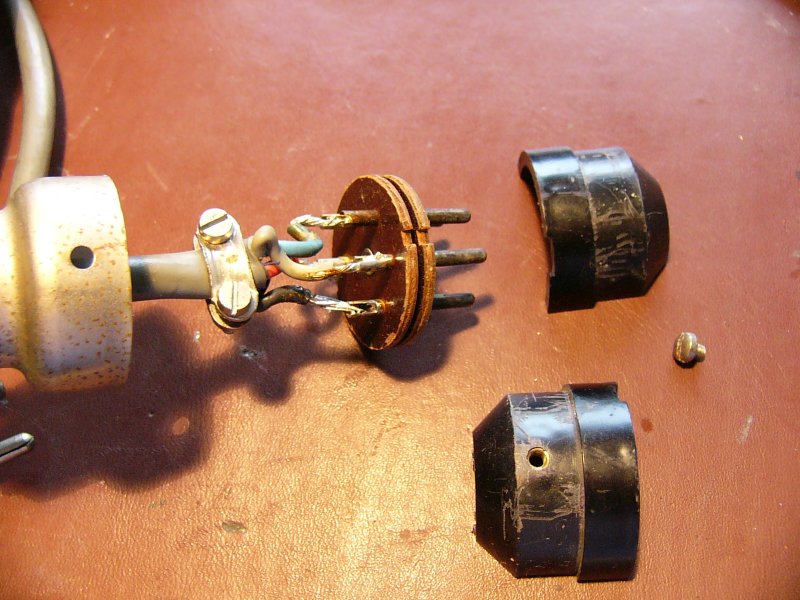

today I found the time to have look inside the 5-Pin-connector. The long cable with the bigger diameter (round, 6 mm) has 4 separate wires with 1 mm copper diameter each. The short cable (oval, 5 x 3 mm) has 2 wires with 1 mm copper diameter each. The center pin of the three pin speaker connector is not used. I attach a picture of the open 5 pin connector.
Best Regards

resume: the 5 pin connector has: red - blue - no connection - grey - black.
can you tell me the collors of the 3 pin connector: ? - no connection - ?.
and can you tell me the collors of the 2 pin netzstecker: ? - ?.
