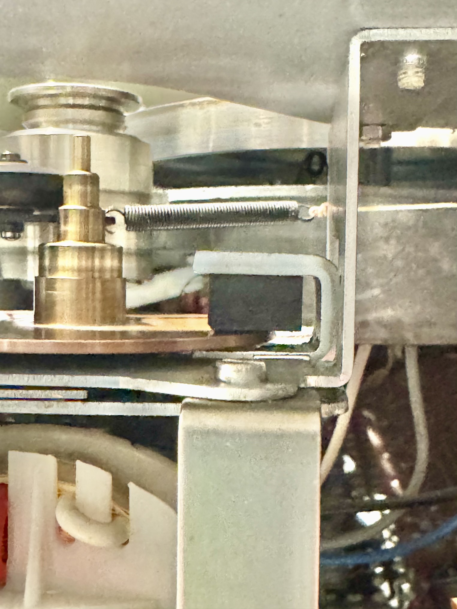

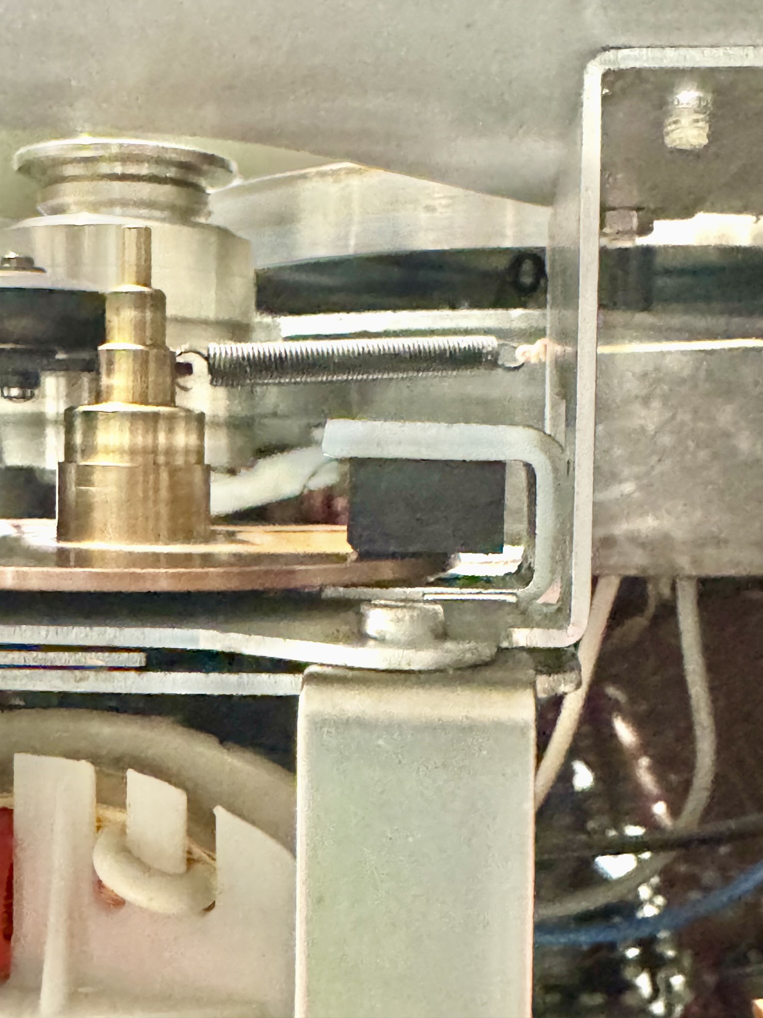

The copper surfaced disk is the Wirbelstrombremse and the pitch knob moves the Magnetschieber more or less over the disk. The is only a very small gap between disk and magnet. Maybe you can just readjust the vertical position of the disk by opening the screw (Madenschraube) securing the Stufenwelle? If there are signs of scratches on the copper surface the problem is shurely related to the disk position.
Beiträge: 1174
Re: PS 420 die stufenwelle vibriert.
#7 Beitrag von wickerge » 09.02.2020, 17:23
Hello Fred,
I just had a look at you first picture. Your copper disk is by far too low!
I expect it has contact to the part of the sliding mechanism below the disk. You have to bring the Stufenwelle upwards by something like 0,8 mm. At the moment I expect the pitch control doesn't work at all, because the magnet is too far away from the disk.

#8 Beitrag von FatFredi » 09.02.2020, 17:27
Dear Gerhard,
thank you, I think you've found what was wrong.
the screw (Madenschraube) is the one I can see on bottom of the Stufenwelle on your photo ?
Beiträge: 1174
#9 Beitrag von wickerge » 09.02.2020, 17:32
Hello Fred,
yes exactly. Bon chance!
FatFredi
Beiträge: 5
Registriert: 02.02.2020, 17:38
#10 Beitrag von FatFredi » 09.02.2020, 19:32
success !
that little screw was really tough to handle !
thank you so much for your time and help Gerhard, don't hesitate to message me if you are around Bordeaux, you will be very welcome ! :beerchug:
